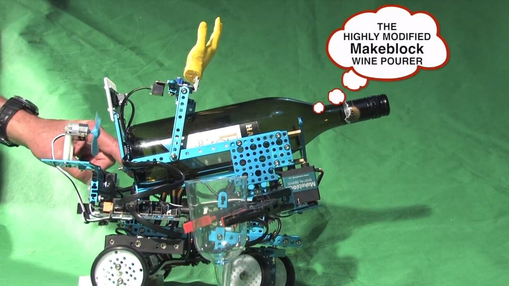

This whole project started this time last year when I got an email about Airblock drones. Makeblock soon appeared on my screen along with the Raspberry Pi in my efforts to learn Python and when I found out I could combine the two, The Butler was born. It all started as a simple Makeblock Ultimate 2.0 kit project and grew from there, and grew and grew and is still growing.

A friend of mine, Adam started building The Waiter and we realized it would need modification to work with the Butler so we could make the film you can watch on Youtube. Function wise, what you see is what you get. Both projects were built to not only learn programming, but to demonstrate to newcomers to robotics the different functions and actions that can be created. As I write this, The Waiter is 500 kilometers away demonstrating to other country students what can be learned at TAFENSW and The Butler is undergoing more Modifications detailed later.
How did the Makeblock robots help to achieve the final results?
Makeblock provided a very high percentage of parts and sensors for both robots. A Raspberry Pi 3B on the Butler along with a couple of home made brackets make up the extras on the Butler. I used Makeblock parts from several different models including a metallic limit switch I found on the Giraffe 3D Printer. Reliability of parts has been quite good considering this is an evolving challenge and nearly always being used to demonstrate or reprogrammed. Further expansion will be done using a ME Arduino (Ranger) board to utilize this boards extra sensors and inputs.

The Butler is continuing to evolve and will do for the rest of this year until I achieve my Certificate 4 in Programming. I have written several programs, one of which you can watch on the Youtube link. I also have an obstacle avoidance program nearly complete and very different from the Mbot. A cruise control program also means The Butler can follow The Waiter maintaining the approximate same speed and distance when following the Waiter. These three programs plus more are now being married together to form one program which should greatly improve the versatility of this robot. Now The Butler can can also be Bluetooth controlled. (A word for those going down the Bluetooth path is that the Bluetooth module must be removed if you put the Megapi board back into computer programmed mode. Your robot will not go back into Bluetooth mode otherwise.)

The Butler is being upgraded from an Orion Board to a ME Arduino Board from the Ranger Robot. This will allow me a lot more sensors and inputs so that an accurate measuring system can be employed. I have removed the Raspberry Pi 3B at this point and am endeavoring to link the ME Arduino to the Megapi board using one program to activate the sensor on the other board until such time as a hardware link can be found. Honestly the sky is the limit for imagining what this robot could do and I can only offer encouragement to fellow coders to get out there and create.
